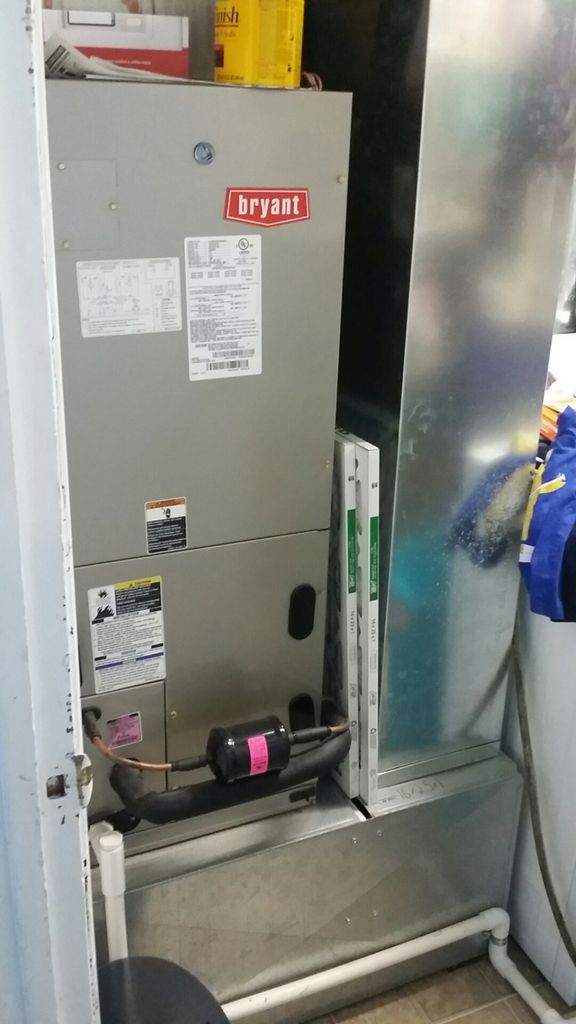

Before and after pictures. And yes since it was her house, so I did some landscaping to make it look pretty.
I guess I never took a picture of the inside when I installed it. These pictures are about 2 years after install date.
Looks alright except I don't like the 1" filters, or the extra drier on the big pipe, or is that thing a muffler?
Either way you did do a nice job with that retaining wall. :cheers:
Honestly if I did it again today I would have put a media filter on it. The outside one is a muffler and it has to have 12" of straight pipe on each side of it according to the book.
I'm guessing that's a heat pump due to the raised pad and because otherwise a muffler wouldn't make any sense to be on a suction line. I dug up some posts talking about mufflers on suction lines, and I found that they are required on Carrier Greenspeed units. That isn't Bryant's version of one of those, is it? What type of thermostat did you get her? Did you go with the wi-fi touchscreen communicating one?
I'm not sure what they call the carrier version but this is a heat pump and its communicating. It is capable of pumping heat down to 8 degrees. And yes it really is. I have been over there several times when it's 10 degrees out and it's out there running like a champ. About 3 months after I put this in the touch screen wifi Tstat came out. I was kinda pissed but what can you do.
Yeah, that sounds kind of like what Bryant calls their Evolution Extreme, which is a twin to the Greenspeed. I've never actually seen one of those in person from either brand, but it's known as the most energy efficient and advanced air to air heat pump that you can get. It's more than just a standard communicating heat pump.
If that's what you got there, it's a really nice system. Even if it's just a standard Evolution unit though, it's still a nice system. You're a good son-in-law. :grin2:

Yeah, that sounds kind of like what Bryant calls their Evolution Extreme, which is a twin to the Greenspeed. I have never actually seen one of those in person from either brand, but it's known as the energy efficient and advanced air to air heat pump that you can get. It's more than just a standard communicating heat pump. If that's what you got there, it's a really nice system.
At least that's what I've been told, as I said I've never actually seen one before. :whistle:
It's a very expensive system as well lol. She was fortunate enough to get it put in for free lol. But her bills will pay off the system from the full electric furnace that was in the house when she moved there

I was over there tonight and took some more pictures since I didn't have too many from before. I usually do not get over there to pick up my kids when it's still light out.
Things I wish I would have done is added a better kind of filtering system and ran pvc to the humidifier so you can't see the junk build up on the walls of a clear hose. Maybe I'll tackle that in the future.
