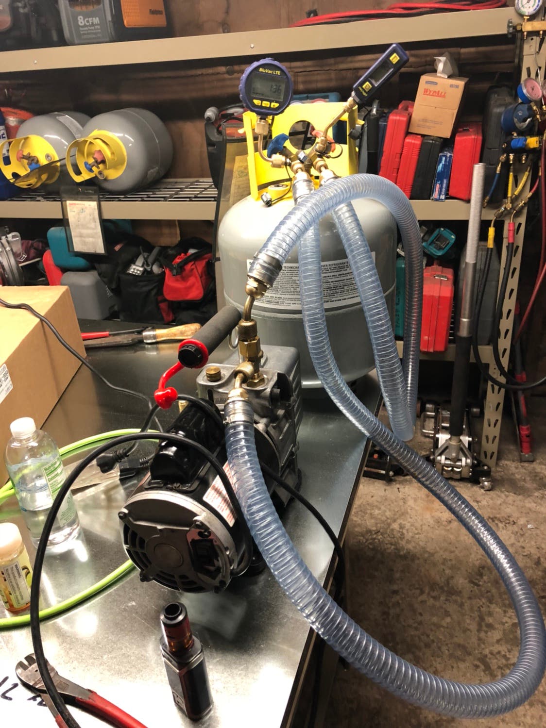

How deep would something like that pull?
The venturi vacuum water pumps in steam systems wont pull super low, maybe 20” - then again Ive never really tried to run them super low.

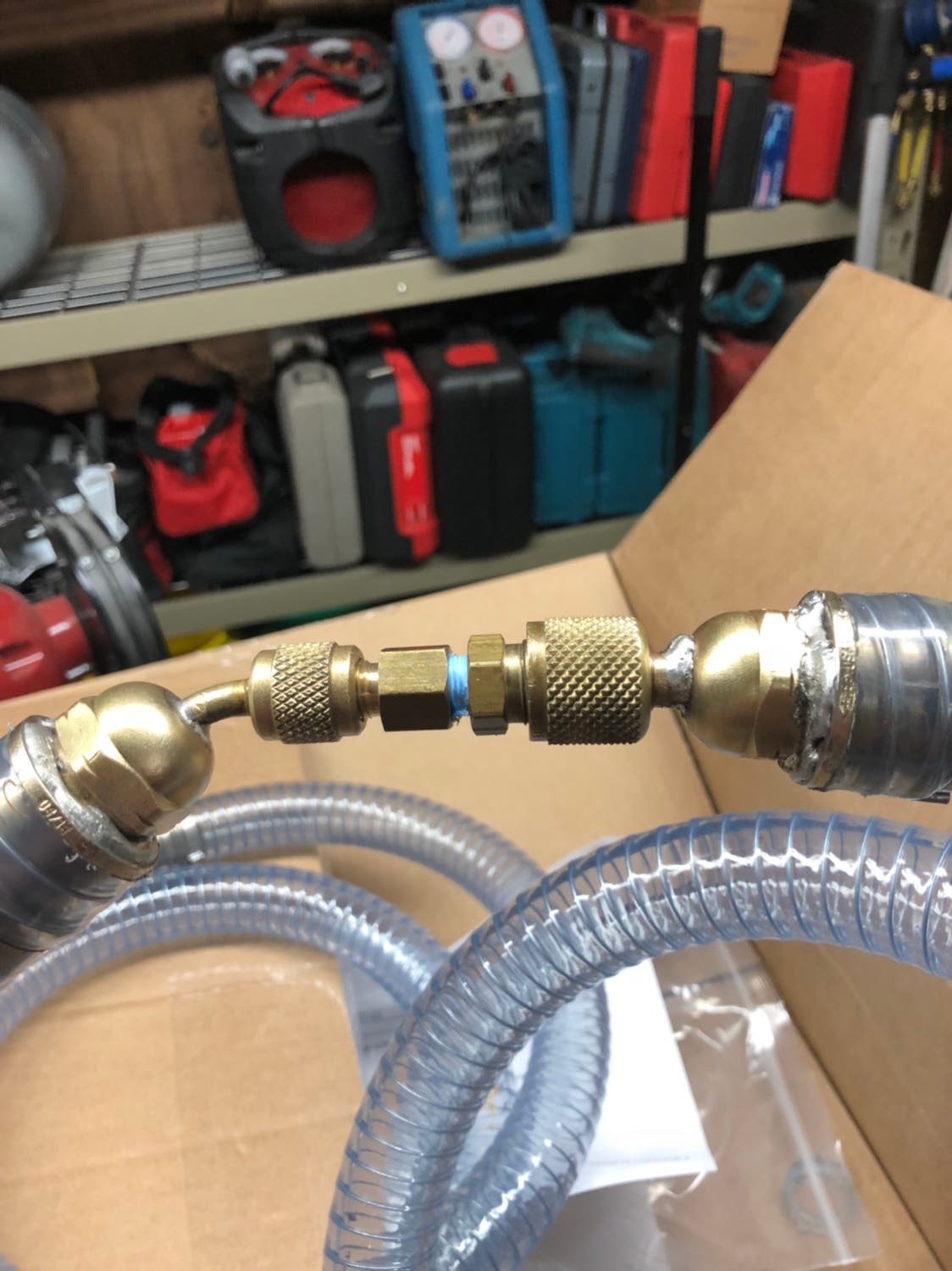

Still limited by the quarter inch connections

What's the limit? I pulled a tank down faster with a 3/8 YJ hose vs a 3/4 inch hose and that was with a 1.35 CFM pump. There are many posts and threads leading up to this one you may have missed out on. Is there something you'd like to see that would convince you it makes a difference.
Save
Appion had a chart showing times to pull a 50 lb tank with ÂĽ, â…ś and we hoses 6 foot long and ÂĽ connections at both ends of all 3 hoses. The difference was huge with the larger hose even though there were two connections at both ends.
Sent from my SM-J700T using Tapatalk
Thats true, but thats not what was causing this. Ive pulled a ton of vacuums in my career, and I cant remember one that gave me this much grief. Even when I pulled through a manifold, and left cores in, and had 1/4” hose for everything.
There was some type of additive in this system or something. The oil in the old compressor was sort of green - I assumed from dye, but now IDK.
As a test I might take one of my recovery cylinders and add a few quarts of water to it and see what the pump does.

Green slime?

This was about the first hour of pull down. The spike to atmospheric was me trying a nitro purge - did almost nothing.
The bump ups are me isolating to change oil. I stopped recording obviously.
Ended up using 2 pumps, one on the suction line, one on the discharge.
Finally got to 500 microns after 4 or 5 hours. During the decay, it went up to 1550. It was getting dark, and I installed an oversized drier, so I called it good enough.
