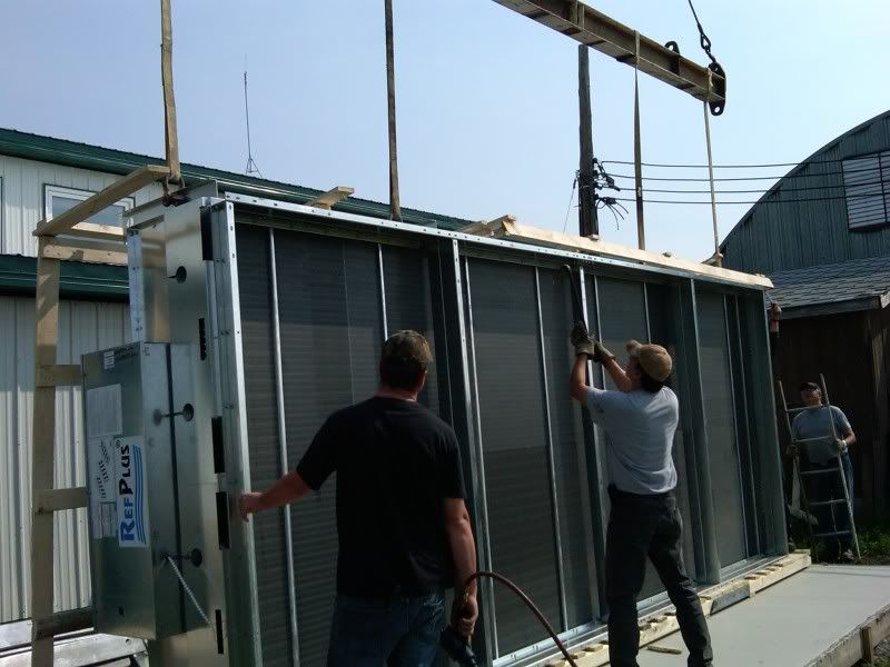

Ripping out 2 condensers that were paralelled and replacing them with one.
Condenser is for a 135hp Sabroe rack that runs 2 filacells in 2 carrot storage sheds. (around 1,500,000lbs of carrots)
Job is in progress, I will post more pics as the job progresses.

Hahaha yeah thats pretty much rabbit heaven. We are installing all of the valving for manual condenser splitting in the winter as the condenser is big time oversized when the outdoor ambient hits -30. When winter time hits and the load is low, we will shut down one side of the condenser and drain it down through a TXV and into the suction line before the accumulator. We will be starting on the piping tomorrow and I will post some more pics as we go along. Ill see if I have some pics of the rack, if not I will snap a few tomorrow.

That is proper piping practice when running a multi circuit condenser on a single system. Equal resistance through both circuits is very critical. If you pipe the liquid outlet any differently you can get liquid pushing back into one circuit and end up with wierd logging issues and need a lot more refrigerant to run the system as you end up with one condenser flooding. If you look at the old condensers, even with the way they were piped this happened and gave us headaches every winter. If you look at the piping on the new coil, everything was measured twice and piped so both circuits are 100% identical valving, pipe lengths etc.

Basically, refrigerant will follow the path of least resistance even if it is a very slight difference in resistance.
If you dropped the liquid drain line from one circuit down and 90'd towards the other, then dropped in the top of a tee with circuit #2, the circuits would have slightly different resistances to flow. While circuit #1 would have a nice easy sweep and a straight shot down the line, Circuit #2 would have a sharper turn to make and therefore more resistance. This could force more flow through Circuit 1 while causing circuit #2 to flood more because that circuit is "restricted".

Like I said, the pressure drop issue is so critical that even though we only need to shut one side down to do the split, you must put the exact same valving on both sides. A pressure drop of even 2 or 3 psi through a valve could play with things if you dont have that same pressure drop on the other circuit. The drop out of the header before you connect also helps minimize the problem. They suggest at least 6 feet but unless you are putting your condenser on 10 foot legs its not too often you can make that work. Factory legs on this condenser were 36" and I ordered 60".
We got a little bit of work done on this job yesterday, I will post a pic just because. No big changes other than a bit of pipe and bracketry.
