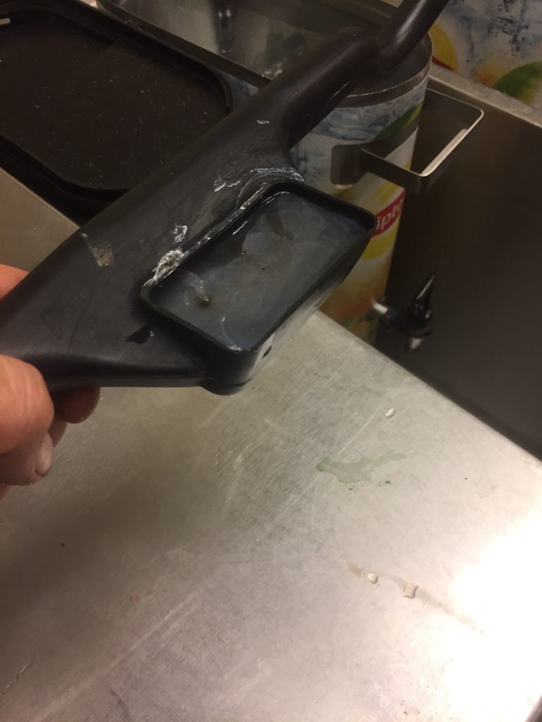

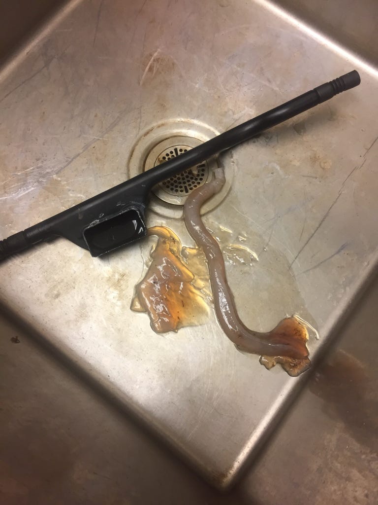

It really looks like grease, honestly but if you say it's not, I'll believe you. The chefs here wash the racks and the wire racks together when they put them into wash but i've never seen anything like this.
I know what you mean on the last comment there about fixing them and all is well and then boom, you feel like an idiot all over.
How often does this occur? You clean it one day, how long till it comes back? I would think it takes time for something like this to grow?
Discussion starter · #24 ·
So I just left the site and guess what... more slime.
What I did today was I took a pack of Care tabs and a pack of Clean tabs and mixed them in separate buckets with a little bit of water. I compared the chemicals I mixed up with the slime/gel stuff. That gel smells and feels just like the Clean tab/water mixture.
I looked at the inner glass and put a straight edge on it and it’s definitely bowed out. During a clean cycle it’s leaking slowly into the drip tray and into the drain where it sits in the trap and starts to coagulate causing a blockage. What I’m having a tough time understanding though is the only time I saw it leak during a clean cycle, it didn’t just drip from the Care pump area, it poured out. I thought with that amount of water that it must have come from the pump or drawer but that drain that keeps clogging up has that large opening right next to the Care pump. So I guess the water could be coming from that opening but not THAT much. Maybe...

So here’s what I did, I went back and the glass was definitely bowed out. I caught some flak for saying it needed replaced because Rational insisted the slime buildup was from the Care tabs that go in the boiler. That and it didn’t leak during a steam cycle so how could the glass be bad? As far it not leaking during a steam cycle... I don’t know. But to prove that the slime stuff came from the Clean tabs I mixed Clean tabs and Care tabs with water in separate buckets and compared them to the slime. The Clean tabs smelled and felt exactly like the slime while the Care tabs solution was totally different.
Then I ran a clean cycle and looked very closely to see where it was dripping past the door seal. I couldn’t really see anything so I lowered the drip trough and noticed that the hinge drain was draining a massive amount! Pretty much a constant stream. Wow, how did I miss that before!
So, armed with that info, I was able to set the glass and seal ok’d. I installed it and adjusted the door and bada bing, good to go. I ran several clean cycles throughout that day and it’s been almost a week without any issues.
Now, this call started several weeks ago, maybe even 2 months ago. I wasn’t the first one in it but by the time I got to it the restaurant’s home office was trying to get me to change the Care Pump. I held off as long as I could because I knew it wasn’t bad but after three trips I finally replaced it but the problem didn’t go away. Then Rational was insisting the slime was from the Care tabs and had me slow water flow, check clean hoses/drawer etc etc. Each time I’d have to tell them to let me know what happens after they cleaned it that night. So this was a long drawn out call where I was led in the wrong direction from the get go. And after it all it was just a door sealing issue. Wowsa.
