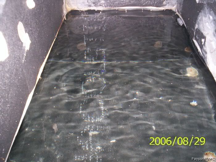

This may not be 100% shame material, but I got some cool pictures to post and this is always the best place!
Went to a NO COOL. Actually, take that back. It was a COD 2 unit maintenance. Another tech and I laugh, because every time someone lately has called in for a "Maintenance" after the peak of summer has past, it is really a NO COOL when we get there!!!
So this one unit has like ZERO air flow. I can here the blower starve like mad and whistle, remove the panel for the EAC and it gasps for all the air!
So I think, HMM???
Must have a return restriction.
The indoor grill has no filter. So now I have to go look in the attic.
Typical Phoenix area ductwork all on top of another and crammed in the attic.
But I crawled all the way down this attic and find nothing wrong as far as crushed flex goes.
And I start to notice that the flex doesn't even sound like it's sucking a vacuum anyway....
So I come back down and pull the EAC and look down for where I think there couldn't posibly be anything to cause a restriction in an open return plenum.
Uh oh!
Water was FULL to the bottom of the furnace base. When it was dark, I could not see the water before.
The plenum under the furnace is insulated metal and must have had TIGHT pitsburgs!
Only a DROP coming from the baseboard, not enough to alert the customer!
This was all I had to remove water. A 6 gallon wet vac
after a while the water level started to drop.
We counted 11 + times we dumped the 6 gallon shop vac!!!
That was enough water to fill a bath tub!
Anyway. I cleared his drains really good with the DrainBlaster2000
That was a weird call. I never would have thought. These plenums always leak through the baseboard with an inch of water, yet alone 20 inches!!!

Discussion starter · #7 ·
razorback said:
so where did all the water come from? surely it's not all from a stopped up drain.
Yes. All of it came form a stopped up condensate drain.
The duct is sealed, so I KNOW that it didn't come from the water heater. Especially since the other return on the other furnace was dry.
The customer was gone on vacation. One of the units wasn't working correctly so they called to have their two units "Maintenanced". I am sure the unit was iced up by time they got home. It was off when I got there so I didn't see the ice.

I thought phoenix was very dry - how the hell did so much condensate accumulate?

I had that same problem once. Couldn't see the water but could tell the unit was starving for air. Coil frozen solid.
Of cousre I'm not as nice as you, i just drilled a hole in the bottom and watcjed it pour out. Also it wasn't encase like that, justthe duct, but no water dripping from the outside.

I had one of those calls once. A 20 ton AHU in a basement. The call was the ducts were making a watery noise. The ductwork 24" spiral went into the basement floor then ran about 80' and then up a wall. I cut into the duct and saw about 20"s of water. No problem, drop the sump pump down and pump it out over night.
Next day water is at same level. The water table had risen up to the water level in the duct. Gave customer option of running the ductwork over head or leave it till the water table drops. They left it. :(

When you have a lot of water like that it's sometimes easier to drop one end of a hose in the water and use your vac to start a siphon on the other end of the hose outside or by a drain.
